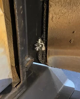

I had the stove shutdown as we were sunny and 20C here today. I took a picture. That was probably a weeks worth or maybe two as I have been only burning about 16 hours a day now.

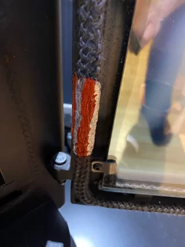

OK - I picked up the red RTV and did the patch. I closed the door with almost no pressure to seat it. Some squeezed out but the surface of the tin foil is pretty clean. I am leaving the door open until tonight when I have a fire. Almost went down to zero C last night, and rainy weather on the way here. I cleaned the glass too.

Still leaks, but the pattern changed. I don't think the tin foil makes a good seal on the stove steel. I will try one more layer. I wonder if I should just use the RTV without tin foil? I would need to make sure I have a small even bead. Would there be an issue having RTV sitting on steel with heat?
The foil is not likely to make a good seal like a gasket. The two ends of the gasket just butt up against each other in the corner.

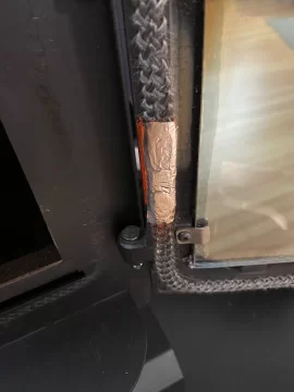

This repair leaked, so I am trying a bead on top. I didn't close the door before it cured (of course). I think if this works, you still need the first layer, so you can get a flat surface. Since the gasket rope is brand new, I hope this works. I will change it for next year if needed.

I don't know who did that gasket end "seal", but neither of my stoves had that. You just butt up the ends (slightly overlay the frayed ends) together with your choice of hi-temp sealant below them. You don't have to do anything with the frayed ends. I personally use Rutlands, but I'm sure there are others that wil work as well.
If you decide to replace the rope itself, that is 3/8". Cut it a couple inches longer than the channel is, remove the rope and lay down a bead of sealant, lay the rope in WITHOUT stretching it, cut off the long end and nestle it in there butted up to the starting end. End of story - no coating of the ends. Yes, there will be a tinge of fray there, but that is okay,
Reinstall the door and close it for a second or so, then open, clean up any squeeze out (if there is any), and let dry. Cure if needed (whatever the sealant directions tell you to do), and go along your merry way.

Update: I had a fire last night although only maybe 4 hours. There was no sign of ash yet on the glass. I was wrong the other day when I said I needed tin foil. I forgot?? that it was already a smooth surface. Just put a bead down on that sleeve they use, and get it as flat as you can. Let it cure for 8 hours. It will make the seal as it can compress as well as the rope gasket under it.
