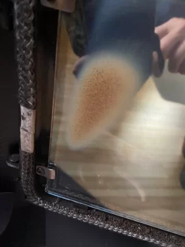

I had the stove shutdown as we were sunny and 20C here today. I took a picture. That was probably a weeks worth or maybe two as I have been only burning about 16 hours a day now.
That gasket should seal using the method I described. On the drolet's (my two anyway) the splice is in the bottom centre, so the foil overlay which I wrap from the inside to the underside of the doorframe cannot be seen from the outside unless you are laying underneath the door.

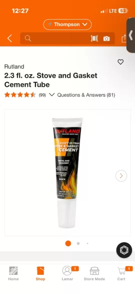

It might just need a re-glueing in that location if the rest is still holding well. Use a little red RTV if that is the case. Let it set up for 24 hrs.
Reactions: Itslay90
The local hardware stove probably has some. Permatex makes it.
Hey, I just got the oem door gasket when I put the red rtv and how do I apply it in straight lines ? does it need to be heat cured ? Or can I just close the door and let it set for 24 hours?

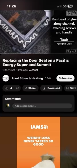

Here is some info I posted which will help. I had some other comments too.
I also posted a link on a pellethead video you can watch.
When you get your original gasket off you will see what the factory used (if it's new). Some will use the cement and some will use RTV. The directions for the cement are on the tube. If you use RTV that is on my post. From that video I posted I am getting the impression that RTV lasts longer.
