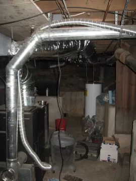

I have a St Croix Revolution and am in a similar position, not quite as bad as 25 foot but my cellar is essentially a crawl space and only the center is dug out, which is where the oil tank and furnace and now the Rev lives - I could not move it any closer to the wall and I have about a 6 foot horizontal run inside. I would say that at best this is marginally acceptable in real life - St Croix themselves do not specify how much venting the unit is equipped to handle, and I feel I am right on the edge. I come out of the furnace to a double cleanout tee, up 3 feet, through 2 45 degree angles with a foot between them, then about 6' with some rise out through the wall, with another cleanout and a 3' vertical outside (required here for code to get above the yearly average snow line). I pulled my combustion blower to clean it the other day, and sitting there on the stove end of the vent I could feel a constant inrush of cold air from outside. It's a lot for the blower to overcome when it's trying to displace the cold dense outside air with light heated air from the stove, and my pipes cool down and clog up quickly in cold temps as a result. But there's no other practical way to route my venting that I can think of, and the numpty who installed my furnace never had thoughts of any of this cross his mind. Once we get through this year I'm going to seriously investigate some sort of booster or wind-defeating impeller to cut down the backdraft. Anyone seen anything like that for pellet vent?

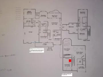

I found the floor plan of the house which I'm sure will help everyone visual things. The side option exit would look the best(Purple box in photo), but again it's about 25 feet and no rise at all in the floor joist space. I could go out through the garage, but the pipe would exit out the front of the house, and I'm not sure if my wife or even I would like the look. Especially if it would darken the vinyl siding as I wouldn't want a long vertical run there. Maybe only a couple of feet.
Right now I don't want to run a boiler and the associated plumbing, but it definately is an option. I also thought of placing the furnace or maybe now a stove in the "game room" area(where it angles out, it's right below the "breakfest" room). If I did that, then I could use a stove like the Drolet Eco-65 and use the 2 vent runs to blow into the master bed and bathroom, and maybe heat at least that "corner" of the basement. But the laundry room wouldn't get much heat from it. Guess I am really zoning my pellet heat with that option. Oh, the masterbedroom and bath are actually under a 4 foot high crawl space. The basement is only a partial basement and doesn't extend under that part of the house.

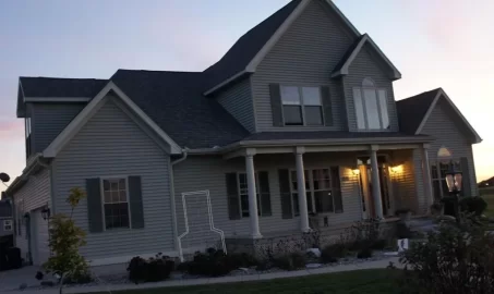

OK, so I did some quick chimney work and photoshopped one in next to the porch in a little cubby area by the garage.

Why the chimney? To look pretty? I dont think they look bad if done correctly?
If you come out above grade high enough, you shouldn't need to go higher? How high off the ground will you be coming out of the house?
One of my vents is in the front if the house. Looks like a standard vent. I have some pavers stacked up on both sides (to hold my leafblower) but also dresses it up a little. If the stove operates correctly, there should be no soot (ever). You can even get some stone decorations to put beside it to camouflage it.
As for the 4 90°'s and 10' horizontal. Thats 30' EVL right there. Thats not including anything else. Can you.do anything else to eliminate some 90°'s? Or get the unit closer to a wall?
Well the exit point on the house would be the white "trim" board area on the photo, between the concrete grey foundation and where the siding starts. It's a 10" rim joist that I would punch through. I'm not sure if I could eliminate some 90's, I'll check when I get home tonight. But that chimney was a quick photoshop job, and as it looks in the pictue it would be coming up 6 feet from the ground landscaped area. I could probably get away with maybe a 2 foot verticle "chimney" measured from the white trim board which would be 4 feet tall altogether. I gues I could also make it vinyl sided to match the house.
But yeah it does look a bit big in the photo, hehe.
Or I could black vent pipe it and plant an evergreen or two "near" it. There's lots of room to distance buffer in that area. How close can you get an evergreen tree to them??

So I when I got home last night I took a look at the situation. I definately think going out the front of the house is the best "functional" option, not necessarily the most esthetic though.
Going straight up(or relatively) through the roof would put the pipe in the dining room, and I don't like extra holes in the roof that potentially could leak. I also want to be able to "remove" the pellet system if a)it doesn't live up to my expectations and b)if it does and I want to take it with me if we move(10+ years from now). So best best is to go out the sill plate.
Now the basement has 9 ft ceilings, so lets so 9 ft for the verticle run there;
Then 90 degree elbow into the garage through a thimble in the sill plate of the utility room/garage with about 8 ft horizontally(can have a rise of 1/4" per foot);
Then that horizontal run would meet another 90degree to come out the front of the house through a thimble;
Then another horizontal run to get it far enough away from the house to meet code, and 90 degree up vertically however much is needed and terminate with a cap.
