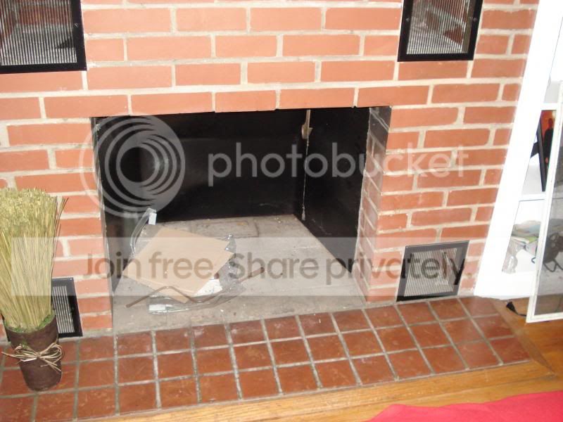

But my brother bought his first house, and has had Oil SHOCk this winter. He has a fireplace opening, with what the chimney sweep called a Heatilator ( metal lined with vents to side of chimney to try to increase efficency)
He is debating a pellet insert. He has a 31.5 W by 27 tall opening, 24 deep. He most likly CANNOT afford new. But looking for maybe a used p-35, OR suggestions on another brand that is reliable with most pellets, easy to service and parts availability, NEED SUGGESTIONS !!
Also, does CT code require a liner pipe in his chimney ( Type cost, its a cape, so 2 story chimney)
Adding a picture of the fireplace ::)

Liner is a must. As for the insert?
The Englnder 25-EPi from amfmenergy is pretty cheap? Factory refurb, with full factory warranty....? Looks like it will fit?
Just a thought? Or a used Santa Fe or Castile, can normally be had pretty cheap?
Link to amfmenergy
(broken link removed to http://www.amfmenergy.com/55trpepi--epa-certified-pellet-insert--2000552000.html)
A liner is necessary. Single wall stainless steel will do just fine. I'm guessing your brother will need at least 25 feet, go with a 4 inch diameter pipe. Have you tried Craigslist for used stoves?

It would be cheaper to buy and install a used stand-alone stove. You could use the fireplace when the electricity goes off or whenever you just want use it. Heatilator fireplaces are 40% efficient as compared to regular fireplaces at 10% .
Just my 2cents.
Just about any unit will fit in the opening but the damper on those heatilators is tough. I suspect a saws all will win the battle for him though.
Have a Sawzall, so yes I can chop it up ! Assume clean air would be through the flue also ???

You might get lucky dealing with the damper in your Heatilator. We've been told in the past by the guys that serviced our chimney (pre-Harman) that our fireplace was a Heatilator. In our case the damper was mounted on the top of the flue and was cable operated. Removal was quick and painless.
dont forget, you'll likely need a ZC box if ya stick a harman in there

No you wont. The thing is all masonry and steel...or I maybe wrong cause I cannot see inside that thing
someone above mentioned "using a sawzall" to cut the old enclosure out....if they do, you WILL need a ZC box
No I meant to cut the top of the damper. Depending how critical the bend in the liner will be passing through, in the past I have had to notch out the damper overhang to create better vertical rise. You don't want to zig zag up and over if it is a real tight squeeze. But yes, one may have to do a z box if you cut out the enclosure...that is a lot of work and a job I might pass on depending upon the thickness of the metal fab.
