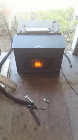

A cousin of mine gave me a 2007 King FP-35 Insert. I do not have a real fireplace and I was wondering if its even possible to install it into an electric fireplace mantle and have a chimney installed behind it as long as I can fireproof the area.
Another question. Could I build a stand for it and use it to warm a garage? Or are they only designed to go into a real fireplace?
Im sure both would work but for the insurance company thats a different story.

My main source of heat is a pellet furnace but I do have electric all around the house if I need to use it. Not sure what I am going to with that insert. I might weld together a stand on wheels and hook it up in the garage when i need heat and disconnected when not in use lol not 100% sure yet.
