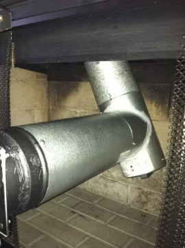

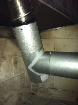

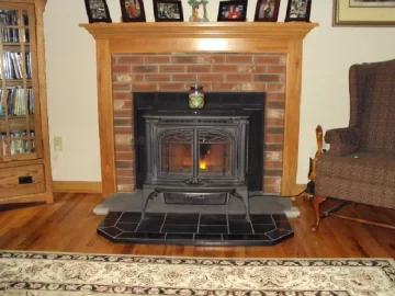

I had same situation as you a few years ago and have a Superior Prefab fireplace with 8" metal flue inside boxed-in fake chimney. It is true that the fireplace would have to be cut up for an insert to fit, rendering it useless and even possibly violating a building code/insurance. You would need to check on those. At the time I was told that an insert cannot be placed inside an insert in my area (the prefab in my area is considered an insert). Also, I did not want to modify my fireplace at all, therefore I decided against an insert and went with a free-standing cast iron Lopi Leyden (Harmon XXV was 1st choice though) in front of it with a hearth extension vented inside the 8" flue with a 4" flex liner to the top and sealed/capped. This was the best decision and I'm glad i did not get the insert for a few reasons:
1. If i move i can take PS with me, pull out the 4" liner and redo the 8" cap at the top - fireplace as good as new again.
2. The freestanding PS if so much easier to maintain and clean - don't have to slide an insert out. Plus I store fake logs & cleaning tools inside the firebox.
3. It looks great (IMO)
Another thing for you. If you have the fan kit installed than you should have a means to use an OAK with it.
Here are some pics:
