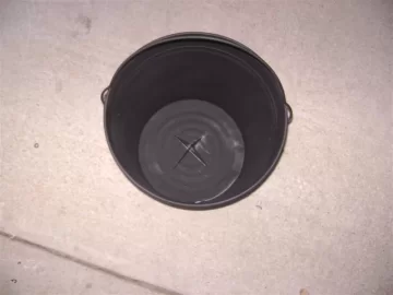

Made my own pellet pail for less than $20. It has a triangular plus shaped knife in the bottom I made from sheet metal and attached with screws to cut the bag when dropped in. It's a galvanized 10 gallon garbage can that also came with a lid.

Video, thats way over my head! It works pretty good but the pail could be a shave wider or even oval shaped would help.

Pail is tough to weld, it's pretty light guage. Tried it and blew a hole as soon as I hit the trigger,also it's galvanized so don't breathe the fumes. Ended up screwing it in from the bottom up.

Thanks, I work in a galvanizing and aluminizing plant, weld down to .012 sometimes when the steel strip breaks. Kinda spot welding. But I could just use something like Liquid Nails. Oh, and I've had the "Zinc Brain" from welding and gouging zinc. Not good at all.
