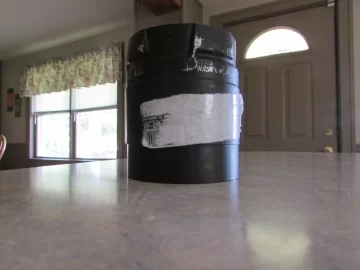

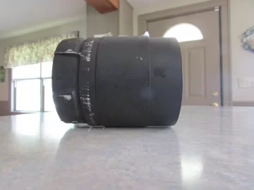

I just received my pellet vent pro Harman adapter today.
It doesn't seem to fit just right , it's seems to not go all the way on.
After putting the sealant on it and it cures will it be ok and stay on securely ?

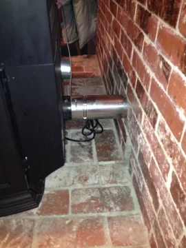

I recently put one on my Harman Accentra and it fit VERY well. It slid onto the exhaust port about an inch deep with no play at all. I felt as though I almost didn't need to seal it. I did, however, use high temp sealant. If your adapter doesn't fit this snugly and deeply, it seems something isn't right. Are you sure you were sent the correct adapter? The model number of mine is 3PVP-ADHB. The "H" designates Harman, I think.

That's the one , it seems to fit snug when I first put it on , but wobbles a bit
when I try to put the T on.
Hmmm. Not sure. My set-up doesn't have a tee until outside the structure. It goes straight out the back through a hole in a brick hearth so there is no way for it wobble. Here is a photo of mine. Does it look like the adapter on yours has seated as far as the adapter on mine?

This is it , pvp - adhb 3inch
