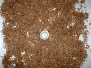

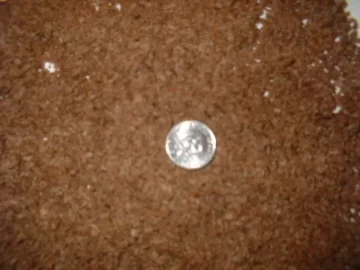

Nice concept. However if you set some basic test standards for the reviews your site can have some meaningful impact.
http://woodpelletsguide.com/tag/quality/ The simple handful of pellets in a glass of water test is quite effective.
I will never purchase a ton of pellets again without performing this simple test.
The pictures I have posted show two types of pellet that I placed in water.
One type Greene Team completely dissolved within three minutes and when the moisture was squeezed out with the aid of a paper towel. The consistency was comparable to fine corn meal.
The Greene Team bag has the PFI label and it appears they have complied.
These burn very well in my Quad Santa Fe producing no clinkers or any cleaning issues.
The other type is called Future Fuel II. These pellets did not completely dissolve even after twenty minutes in water. Whole pellets, large chunks and bits of multicolored wood and what I suspect is corn are among the mix.
Given the fact that after twenty minutes some pellets did not even dissolve means that there is some sort of additive within them. I would speculate that the stuff was really intended to be animal bedding
and got repackaged as fuel. Big profit there
These did not burn very well at all. I burned three and a half bags. The last half bag I burned produced a clinker the size of my fist. Created a pellet bridge in the drop shoot and there was a piece pf paper jammed in my auger at the top of the drop shoot. (the paper was at tag that said "whole corn 50 pounds). One of the bags also had a piece of plastic that I pulled out of the auger.
The stove was setup at that point for a hopper fire.
I returned these pellets to Home Depot and exchanged them for Penningtons Natures Heat brand. The manager knocked the price down to 256. a ton.
He then put my returned pellets back on the floor to sell. Even though I showed him all the pictures, clinkers and the results of my water tests. I did tell him that these were not premium pellets. Even thought the bag has a small line that "meets or exceeds premium fuel standards". He said some stoves will be able to burn them. He might be right. I am thinking industrial stoves or automatic burner with self cleaning function. They still should not be sold as premium.
Before I unloaded the replacement ton from the truck I did the water test on the penningtons. They dissolved with two minutes and were of a little courser texture and lighter in color than the greene team.
They are burning just fine.
So back to the concept of reviewing pellets.
Without some basic testing most of what people post about pellets is quite meaningless.
After doing the water test on three types of pellets.
I have hopefully related a pretty good idea why the future fuel makes clinkers and the other brands do not.
So what is a good review? Perhaps a review that uses the 5ws of reporting. Who, what, when, where, and why.
If I had water tested the first ton those pellets never would have made it off the truck.
Good luck with your blog.
