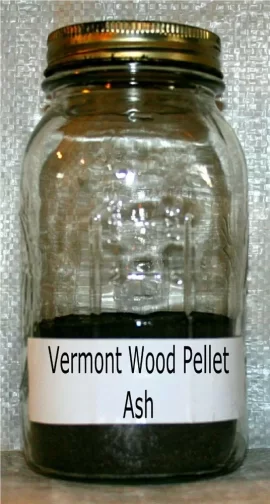

Actually I did test the Vermont Wood Pellet Co's last year. I tested them for Bt Ent as a mystery pellet. Results were never put on my testing list as it was late in the season. I will try to do them this year.
https://www.hearth.com/talk/threads/51871/
Temp average 242ºF
Ash volume was at 12 ounce mark on jar.
Ash weight 3.52 ounces
Ash Percentage 0.275%
Fines 3 ounces total
Diameter .255”
Length 1/4 to 1”
  • [Hearth.com] Pellet sampling on a broad scale. Multiple burners=entertaining???
