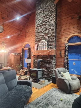

Can you post some pictures of the installation of that big rock?
Will Def try that next time I have to cold start ty.

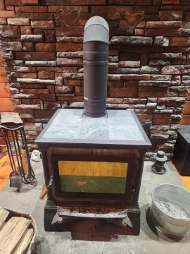

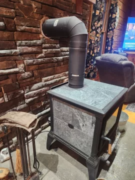

Please see attached pics

Ok, I do see an ash bucket on the side of your stove. Do you shovel from stove to bucket? That will definitely do it. I have a homemade scoop I grab one at a time and dump it in my pail outside. If I scooped from my stove to a bucket in the room my house would be wrecked.
Furthermore don’t leave hot coals in a bucket (esp galvanized) on your hearth for long. They do produce CO in the coaling stage. Also hot galvanized coating isn’t healthy to breathe in.
I know a picture is only a snapshot in time and maybe you were in the process of a cleanout but I thought it would be worth mentioning anyways.
That is my ash bucket for years now(even with the VC). I am pretty anal about carefully dumping the ash pan with both the bucket and pan at an angle to lesson the chance of a plume of ash.......then it goes right outside on the stone patio for a day or so to cool off and gets dumped. Never stays with ash in it in the house for multiple reasons - especially since my entire house is wood lol. I used to have to weld galvanized so I know how nasty that stuff is.

Gorgeous setting for that big rock! It looks great there.
These stoves like a fairly strong draft. Draft is likely a bit weak and compromised due to the short vertical stovepipe then two 90º turns in the flue path combined with the 3'? horizontal run. That is effectively reducing the overall height by around 6 feet. The cold exterior flue is not helping. Adding a probe thermometer for the stove pipe and place it about 18-21" above the stove will help with regulating the fire.
