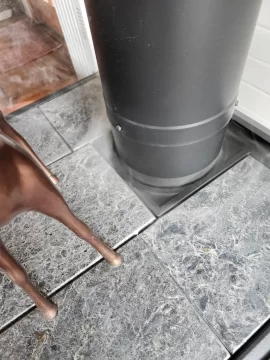

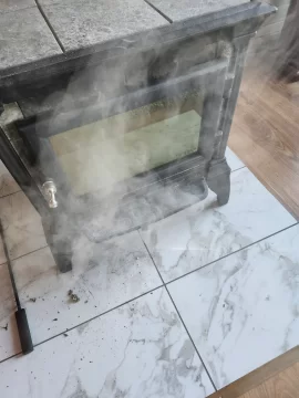

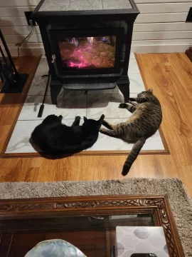

My partner and I had a new Hearthstone Castleton model stove installed in March 2025. The installation is at an elevation of about 1000 feet off State Highway 11 in Pickens County, South Carolina. We followed the break-in instructions and then in December began using the stove on cold days. From the beginning, its been difficult to start fires and during the process, the flue draws poorly and smoke escapes into the house. By January 2026, starting the Castleton became easier and even routine but some smoke still accumulated in house during most start ups. After a general temperature warm up ( and therefore not using the Castleton) and being away from the house for a day, start up this morning was VERY difficult and VERY smokey. Prior to attempting to start a fire, the existing ash was very lightly sprayed with water mist to control dust and then the ash was scooped out of the stove. When attempting to start a fire, the Bypass handle is open and the air control is at high position (left). This morning there has been smoke escaping from the top of the stove and the interior is full of smoke. We are particularly concerned about the smoke escaping from the top of the stove. Start up has never been truly easy.

Can you describe the stove setup? What floor is it on? How tall is the flue system? Is it 6" diameter all the way up to the cap? What is the outdoor temperature when this smokey start was worst?
The outdoor temp was about 45F. I'm not certain of the flue diameter but its constant through to the cap. The flue comes out of the top of the stove, then a 90 degree bend to go through the wall, then another 90 degree and straight to the cap. From the ground, the stove is on the 'second' floor and then 7-8 feet ( absolute guess) to the cap. We're experimenting with ways to warm the flue ( eg a candle) to see if that helps.
Definitely try opening a nearby window a bit and see if that helps improve draft. If so, the stove wants an outside air supply.
It could be that the flue system is too short. The two 90º turn slow down the flue gases quite a bit, especially if the horizontal run is long. They effectively reduce the flue system height by about 4 ft.
The recommended minimum chimney height for top of stove installation is 16 feet (4.9 m) off the floor or 13 feet 10 1/8 inches (4.3 m) from the top of the stove. For a double-90 turn flue, about 20 ft vertical height is the minimum. If access to the roof is safe and easy, as a test, you could try removing the cap and inserting a 3-4 ft length of inexpensive, 6" warm air duct to the top and see if that makes a notable improvement. If that works, add chimney pipe and brace it at the 5' level over the roof.
+ on all of the above. Most of us start fires with stove door open, and keep it open for, sometimes 5 mins, sometimes for 1/2 hr. It looks like you do the same. A couple of things that have caused me smoke issues; 1) any appliance operating that draws air, kitchen fan, wall heater. Both will pull air down the chimney. I need to keep my front door open 4 to 6” for about 5 mins. Door is 10’ from the wood stove. 2). Also, central heating/air when operating, has caused me issues. And I can’t say why. Turn them off during startup.
Reactions: wetwood4life
If it's only on a cold start up, and not when the flue is warm on a reload,. maybe you have to reverse the draft before.youn start the fire.
I have a propane torch that I use to light the splits on a cold start. I have had twice that a lot of smoke came out (different stove, similar set up with 90s).
I always run the torch pointing into the stove pipe for 20 seconds before I light the wood.
That creates warm gases going up, i.e. the draft going in the right direction rather than a column of cold air flowing down the flue into your stove and with the smoke into your room.

Oh, BTW, the cats seem to think it's just fine!
