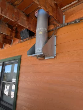

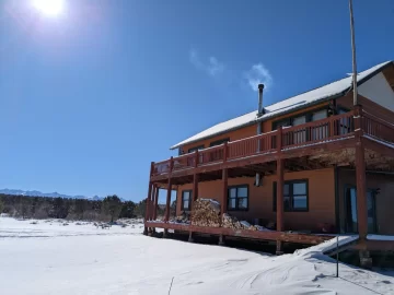

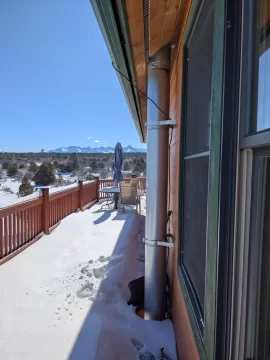

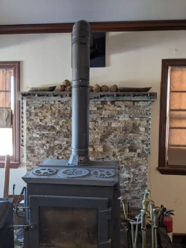

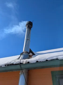

Thanks! I agree it seems like a chimney issue, but as I said, two different stove company guys have said it's OK. The second one initially thought the math was wrong, but after he worked through it, said it was ok. I'll attach pics of the setup. It's all 6" double or triple wall. It's straight up 4.5', 90* elbow through the wall about 2.5', then straight up outside to the cap - another 16 or 17'. So maybe 23' vertical, 3.5' horizontal. I'm at 8400' in the San Juan Mountains (Colorado).
I did a deep clean last summer, and although the cat looks ok and seems to still fire ok, I did order one from WS. The stove is 10 years old and I'm pretty sure the cat is original, so it's definitely time. (That said, the house was an STR with not a lot of use for the first 5 years, FWIW.) Unfortunately they're indefinitely back-ordered! From other threads regarding this part, it seems like it can take from a few weeks to a few months to get one.

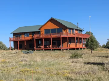

I agree with the thought the Ideal is underrated. My house is 3800 SF, and of course I don't expect the stove to heat 100%, but I'd say it's over 50%. On many winter days, the heat only comes on a couple times in the AM, then stays off the rest of the day - there' s a lot of passive solar, so that of course helps as well. The first floor (I said basement earlier, that's not correct - for some reason I think of it as a basement though) where stove is is less than 1500SF, but heat goes up the open staircase to the great room (28'x44') above fairly well. I included a pic of the house overall so you can kinda get the layout. And as I said, if I fill it at night, it will last through till morning pretty well - 8-10 hours, even burning aspen.

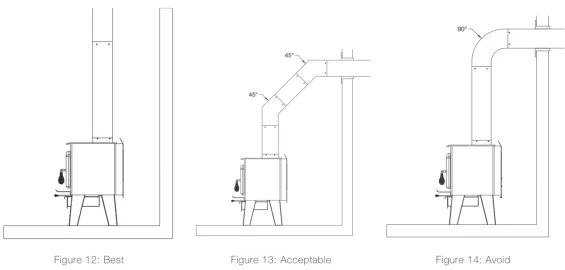

The two 90º turns in the flue are effectively robbing about 4-5' of chimney height as it pertains to draft. This makes it closer to a 19-20' system. Then add the very high altitude requirement (see chart) plus a cold chimney and I think that explains the draft issue. Adding 3 ft of chimney (with a brace at 5' above the roof) will help. Another improvement can be made by softening the interior 90º by switching to a pair of 45º elbows and an offset.

Thanks, that's very helpful! I'm a little reluctant to add that 3', as it would put the cap at or above the roof peak, and we get some screaming winds here. I'm also guesstimating that last section at about 7', which would put the overall at 23' - I might be off +/- a foot. I do like the idea of 2x45° angles however. Maybe the combination of that and a 2' add to the upper section? And thanks for the chart. I knew altitude played a roll in chimney height, but had no idea it was so substantial! Probably won't do anything until late spring at the earliest, but in any case, I think you both have talked me out of the Hearthstone!
Looking at those pics I'd guess that chimney to be closer to 20-21"...which between those 90's and the elevation, I do think that is your main issue...like Begreen said, adding some height (with proper bracing) and eliminating those 90's should make a nice improvement for you.
Also, use binoculars to keep an eye on that bird screen on the cap...its not too uncommon for those to ice/creosote closed when its really cold...and that makes for some really poor chimney draft! I just had to take the screen off of the chimney cap over at my sisters house last week...about 80-90% plugged, she had been complaining that it wasn't keeping up with this cold snap we've had...well that's why!
Every little bit helps.
Also, is there 2" clearance from any combustible where the chimney pipe passes through the soffit? It looks tight there, but that could just be the camera angle.
