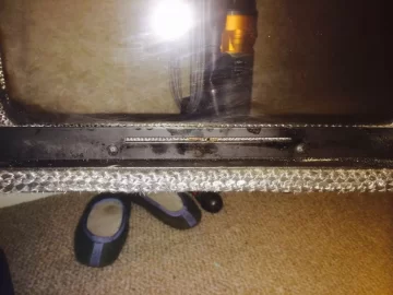

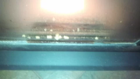

Hi. I have a United States stove company 5502m king pellet stove.. Attached are some pictures of my glass. I had mentioned in a previous post that my glass was getting dirty rather quickly. After some air fuel
Mixture adjustments and running the stove on a higher temp because of colder temps it doesn't seem to be as bad. Although I want to make sure there is a air wash in it. I'm guessing it's that small slit on the Piece of steel on the bottom? [Hearth.com] Pellet stove glass air wash[Hearth.com] Pellet stove glass air wash
I don't remember which thread it was, but yes, you're supposed to cut the window gasket at least the width of that slit.
I have read two conflicting things about the gasket.. one said to remove the plate and just cut out the exposed gasket. The other said to cut through the entire gasket.
I cut through the entire gasket, so there is a small 6" or so wide gap between the window and the door. Not only is my stove running better, but the window has stayed super clean the past day.. on HR-1.

So did you remove the gasket cover where that slit is and cut it? Or did you just cut through that slit in the steel? Also the holes in your burn out are excellent idea! Could you show me where you out those holes?

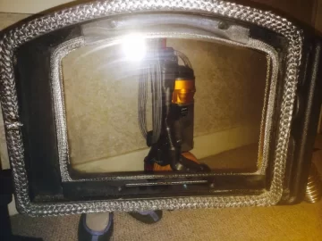

I removed both steel plates and completely removed the glass. While the shorter half was scrubbing the soot and crap off the glass, I cut about 6" off the gasket (3" from each end), then replaced the gasket around the glass and replaced the glass.
** Please note: I don't know if I was supposed to cut all the way through the gasket or not, but that's what I had read in one thread, then after I had performed the surgery, I'd read in another thread to not cut all the way through, so I don't know which way is "right". **

The outside view.. and you can see there is no gasket in the middle... and the stove has been running on HR-1 for 36+ hours now (or longer, maybe?) and you can see the glass is still fairly clean.. no black gunk.. just browning gunk.

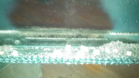

The inside view.. you can see there is no gasket behind the slit.
