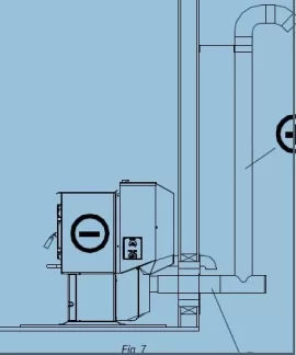

Here is my installation option. What brand of the venting would you recommend?

There are several different brands of pellet vent out there, but I used Simpson Duravent Pellet Vent Pro myself. Try and purchase the best you can afford and it must be double-wall pipe specifically designed for pellet stoves.
