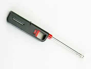

And if you light your stove manually the lighter will last indefinitely...
Glad I dont have to worry about that problem [Hearth.com] Pellet Stove Lighter Longevity Question
