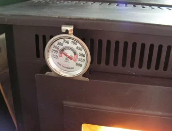

How about a el cheapo oven thermometer from Wal-Mart for $5.99. All you have to do is bend the bottom edges to fit the convection blower output on the front of your stove and you're ready to go. Not laboratory accurate but it gives you fairly good idea of what your stove is doing.

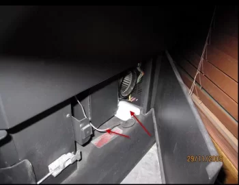

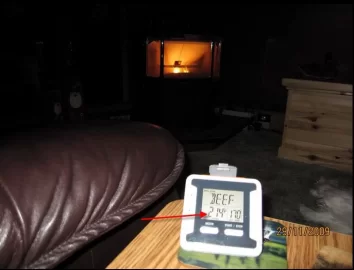

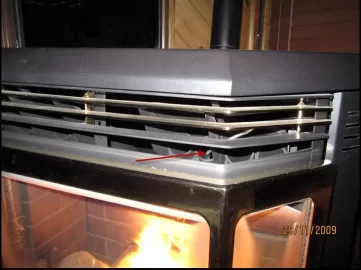

.......here's the 'remote' thermometers I spoke of earlier.(someone mentioned a link wasn't working).... (broken link removed to http://www.canadiantire.ca/AST/browse/8/KitchenBath/GadgetsAccessories/Gadgets/PRD~0429135P/Accu-Temp+Wireless+Cooking+Thermometer.jsp) and (broken link removed to http://cgi.ebay.ca/ET-71C-Maverick-WIRELESS-REMOTE-Cooking-BBQ-Thermometer_W0QQitemZ300306076912QQcmdZViewItemQQptZLH_DefaultDomain_0?hash=item45eba314f0) ........I'm using 'Thermometer 1' with my 'remote' receiver displaying 214F air output temp ....unit about 15 ft away from the stove beside favorite chair and with stove percolating on Low ...... again my setup looks like pics below.....(click on pics to enlarge)....... cc :)

I leave mine in all the time and turn it on every so often to see what the temp is compared to the heat setting and such and then shut it back off.
Hi Canadian Clinker
That is a slick remote thermometer, I like that one the best!!!

Hey Don.......it's a lot of fun watchin how the stove performs with different types of pellets in it.....better than watchin old 'reruns' of the 'Forest Rangers'..... (well almost!!) ....cc :lol:
