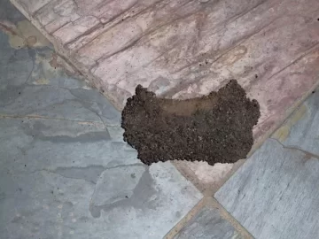

Was it like this [Hearth.com] Pellets not burning completely Englander PDVC that is called a clinker, welcome to the clinker collectors club.
To get rid of these you have to make sure that all gaskets are good, all doors are properly closed and latched, that the wear plate isn't worn or inserted into the stove incorrectly, that the entire combustion air path is clean (starts outside before the OAK and ends outside after the vent termination) cleaning should involve lots of elbow grease, brush work, high air flow devices, and then making sure that the stove is in the proper mode and the lower 3 are whatever they should be.
It also helps if you burn a low ash pellet.

Was it like this View attachment 150176 that is called a clinker, welcome to the clinker collectors club.
Yep I am blessed with those now. I want to get into the combustion fan and I thought I had a spare gasket that now cannot be found. I'll keep plugging away at it and see what works. Or it might make a nice planter in the yard :)
