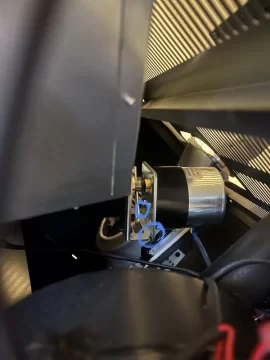

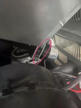

The feed motor might have moved during shipping? The motor was on and turning but not turning the auger. We could spin the auger freely (no jam).
The metal plate on the feed motor( circled in pink) was not in contact with the metal plate on the auger side. So I had to push the motor up toward the auger, so that the two little tabs on the auger side (circled in blue) would make contact with the metal plate on the feed motor, and engage the auger.
Just posting the solution in case someone else runs into this problem. It’s been working all day today, hopefully it continues to work.

No, that makes no sense. You should not be able to "push the motor up" as you describe. That hair pin connects the auger shaft to the motor shaft, the auger cannot come down further, so I suspect the motor has an internal problem, and will happen again, probably when it gets hot.

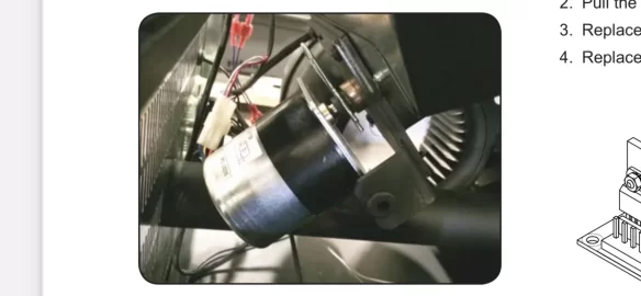

If you look at the other side of the Pelpro Feed motor you will see a black tab connected to the auger end plate with a round circle. See picture below.
This tab is a motor stop so when the motor shaft turns the tab stops the motor case from turning also. If the motor hangs down too much it may not hit the tab.
