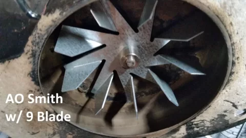

The old motor is 3000 rpm but no amp rating. I believe when I cross referenced it the rating was 1.0 amps. I think the new motor is 2900 rpm at .91 amps.What are the stats of your new motor? The 9 blade is identical to my quad fan. It should be fine with yours

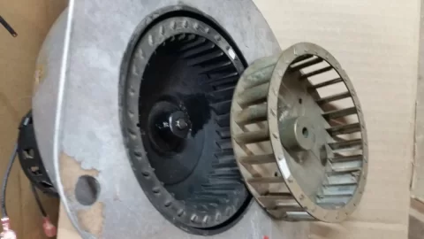

![[Hearth.com] Pelpro aftermarket combustion fan [Hearth.com] Pelpro aftermarket combustion fan](https://www.hearth.com/talk/data/attachments/224/224671-36bd28aefce6bea6ab1de2272c230e33.jpg?hash=dp6mclsnke)

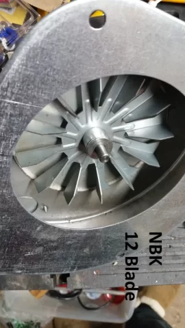

![[Hearth.com] Pelpro aftermarket combustion fan [Hearth.com] Pelpro aftermarket combustion fan](https://www.hearth.com/talk/data/attachments/224/224672-0b512898aa0d944ee0b99c8c4c5de7af.jpg?hash=MoYms4-3zT)

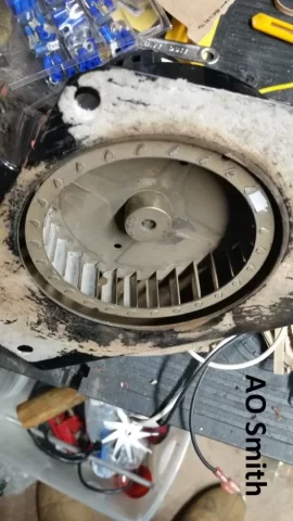

 ![[Hearth.com] Pelpro aftermarket combustion fan [Hearth.com] Pelpro aftermarket combustion fan](https://www.hearth.com/talk/data/attachments/224/224674-546928180717dbd9a3e59045754149ba.jpg?hash=nLUOVtgNw9)

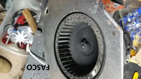

 ![[Hearth.com] Pelpro aftermarket combustion fan [Hearth.com] Pelpro aftermarket combustion fan](https://www.hearth.com/talk/data/attachments/224/224675-715a6494f4c356e9805a654e7227efd0.jpg?hash=lBEaNxky_J)
![[Hearth.com] Pelpro aftermarket combustion fan [Hearth.com] Pelpro aftermarket combustion fan](https://www.hearth.com/talk/data/attachments/224/224676-ab3790c72a9e460b4394dbdcd7183dcd.jpg?hash=7IFC7yAojV)
Had to go back to a fasco a143

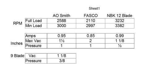

And yes, that is the original equipment. Believe it or not I bought the stove 2 seasons ago brand new from Menards, they had it clearanced out to $300, but was only available in a few stores in MN, WI, and IL. I had mine shipped from a store in Chicago, with $100 frieght. I think they must of had some of these sitting in the back of a warehouse somewhere, because they quit making them years ago! Either way, I was happy to find it, my mom has had one she bought brand new in 2007, and it is still going strong, original fans and igniter!I finished testing the 3 fans.

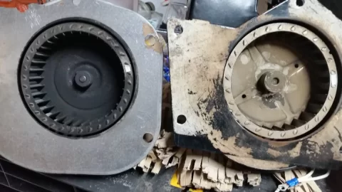

1. The one I got from zhass which is an AO Smith and appears to be an original.

I would, after seeing the fans, still suspect the possibility of a fan issue. The replacement that was in it wasn't the right fan. Looks like it was a 5" squirrel cage, and although you would think that bigger round should be better, I don't know if it would be ideally positioned over the stove where it mounts up and pulls air through. Also I wonder if it didn't vary speed either, which would cause issues. Fingers crossed that the original one works out much better, and that you can sit back and relax, besides pulling the whole assembly once in a while to clean it.That's an amazing price. I bought this one used for $600 although the seller delivered it and brought it in the house so I didn't have to lift it. The prices for stoves vary tremendously on Craigslist. $400 for a rust bucket to $3500.
I have not installed the fan as yet. Just finished testing last night. At this point I'm not convinced the whole problem is the fan. Look at the color difference between the two squirrel cages. Yours seems to be burning much cleaner. The picture of mine was AFTER I cleaned it again. Guess I'll just install this one and see what happens.
I might post my test results on a new thread and see if there is any more input. Your thoughts?
I would say put the one I sent in, you know you had issues with the fasco previous, so give the original a shot, and see. I guess if it's burning like it should, let it run for a couple months before you pull it apart to clean it, and then decide if you feel like you can go a full season without messing with it. My mom ran hers for the first 8 years without ever once touching the exhaust blower... Not saying that's okay, but I would think you could make it through a full heating season at least, and do a good spring cleaning and oil the bushings on the motor. And don't get me wrong, there will be some build up on the blades after a little running, but it should still work fine, as long as the blower housing isn't filling with Ash.That's an amazing price. I bought this one used for $600 although the seller delivered it and brought it in the house so I didn't have to lift it. The prices for stoves vary tremendously on Craigslist. $400 for a rust bucket to $3500.

That's my plan. I have to remove the adapter from the NBK and install on the AO Smith. Silicone and let it sit overnight.put the one I sent

HelloYou stove was designed with the squirrel cage I wouldn’t recommend changing to the impeller blade. Unless you have a magnehelic guage and can virify the draft could be matched. Alot of testing!
