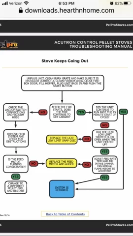

The chart I found in Pic 1 below is very helpful. However the low limit was good and the vacuum switch was good.

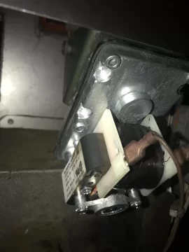

The problem and solution was replacing the Hi Limit switch - Bingo!

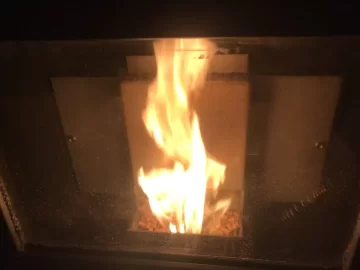

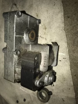

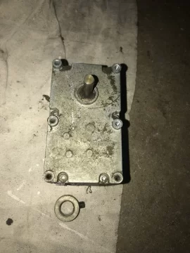

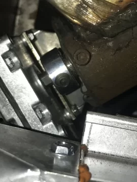

The stove runs for approximately 1/2 hour while slowly feeding less & less pellets until the fire goes out.
The problem ad solution here was to replace the original tired old auger motor. Bingo!
