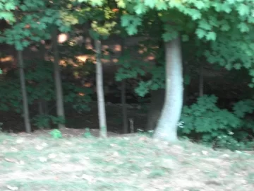

Bad pic attached, but you can kinda see it down there in the valley.

It certainly doesn't flow very quick and there's not much head (the angle downhill), but i bet i could move a couple small rocks and make a bit of a velocity stack of sorts to increase flow speed before the entrance into the shaft.
Search web for micro-hydro if you haven't already. What sort of vertical drop do you have?
not much. maybe 1 foot per 10 length.
