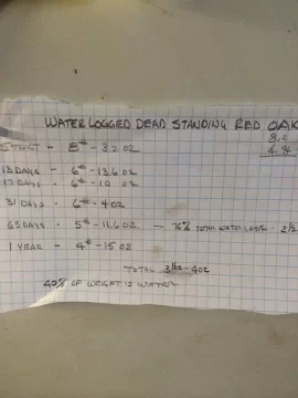

I'm going to go out on a limb here, saw it off if you can, but standing red oak doesn't dry while standing, the last big tree I just cut was so wet when the splitter cutter entered the split the water would squish out the sides, it had 1" plus punk. Red oak trees do not dry while standing, they rot and fall down.---But the upside is if you split it, it dries fast. I've got numbers on some splits I've recorded, like the yellow pine.

Here's the results of weighing just one piece of standing dead red oak. The last photo was today a year later, maybe two. It's stabilized and will gain or loose weight according to humidity.
Well, the second photo didn't upload, but it's the same finished weight as posted.
This wood squished water out when I was splitting it.
