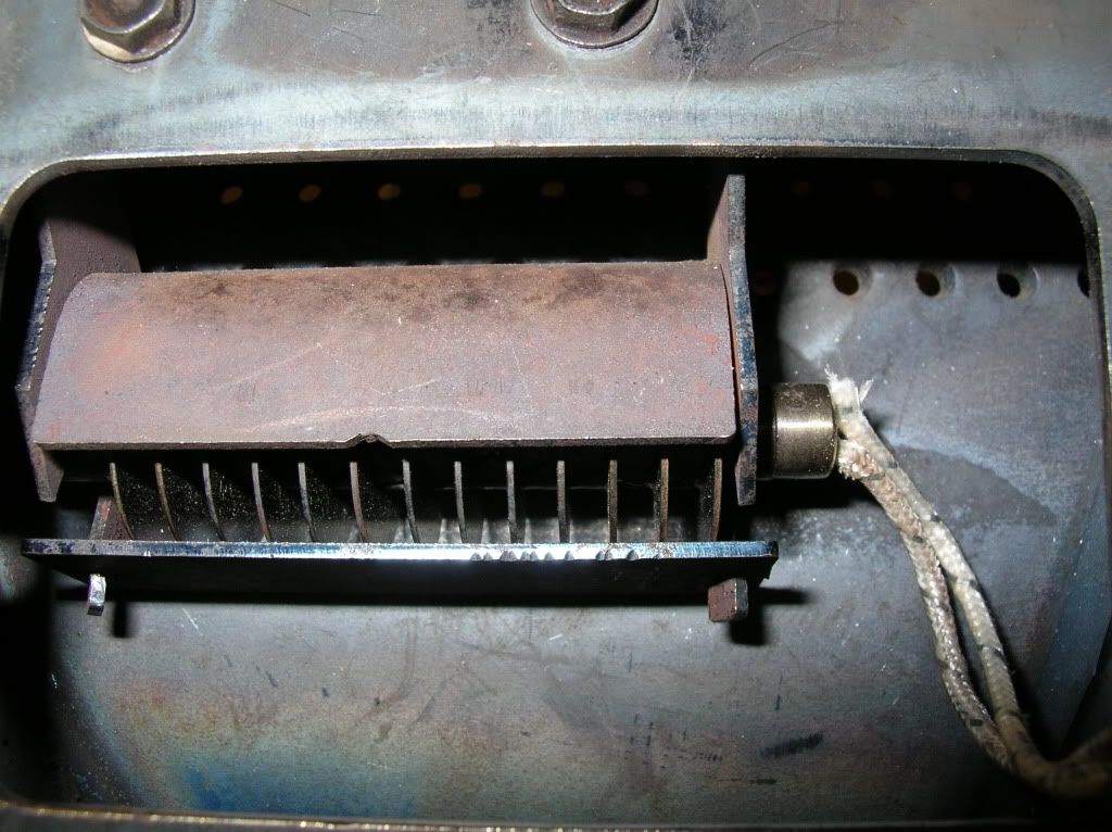

These photos are of the new and improved (maybe)burnpot that was installed in my PB105 boiler today. It appears that the burning surface is still stainless with cross bracing welded to the bottom.[Hearth.com] PF100 and PB105 Burn Pot Issues
Thanks for the great pictures Wil. It would appear that with the added bracing to the bottom side it would no longer be possible to use use the original igniter with the fins. Would you agree Wil? I remember that you were given one of the new air pumps to see if that would resolve the issue. This could get interesting.
Looks like a different convection air hole layout. Where will the finned igniter go for those that don't have the hot air ignition. Hope this is just an experiment and not a band-aid fix! Thanks for the update Wil.
Yes, I do have the pressure ignition system installed in my boiler, I really like this, ignites quickly. I agree, the finned igniter couldn't be used with this burnpot.I have some mixed feelings about this being a band-aid fix, my thoughts were to have the burnpot burning surface with a higher heat resistant steel alloy. I know that this nickel alloy metal is very expensive but.....it's very possible that the thoughts were that these cross braces will act as heat sinks to lower the temps on the burnpot, maybe. I was told by my dealer that during testing that Harman discovered that different pellets burned at different temps (surprise, surprise) so.... my guess is, yes, depending on what pellets one is using determines the time prior to a bubble forming.
