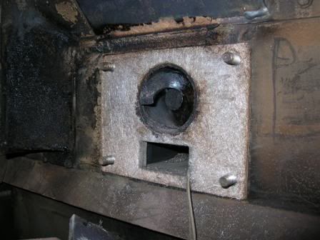

    Not difficult for someone with some home mech. repair experience.
    Shut power off to the furnace.
    Either disconnect the igniter wires (you can see the igniter wires in the picture) or unbolt the igniter and feed it thru the burnpot hole. The igniter wire connectors are located behind the lower cover under the pellet hopper.
    Remove the Fire Brick and it's mounting bracket.
    Remove the 4 nuts holding the burn-pot to the fire box. It's gasket is very fragile and should probably be replaced before reinstalling (it looks like fiberglass matting). The 4 studs that the burnpot is fastened with are anchored in the thin firebox metal so be careful to not over torque the nuts. The back 2 nuts are a bit difficult to get to and blind so you may need a socket with an extension and a u-joint or just a combination wrench.
