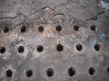

I found the common denominator! common denominator is.....drum roll please.....If you have a PB 105, your GONNA have burn pot problems. Just discovered a bubble in my burn pot.:mad: Gonna switch out my burnpot today and fix my old one. I'm very unhappy. Now my bulk feeder likes to make sawdust outa the pellets...this morning I wake up to a stove not burning...7 blinks (no such thing ...BUT I can fu%^$ing count):mad: I'm selling my new accentra ( (broken link removed to http://albany.craigslist.org/app/4150424724.html) ) I am not at all happy with my stove or Harman. I'll pull this POS out and move south. I don't need this aggravation.. did I say I'm not happy?

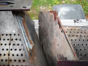

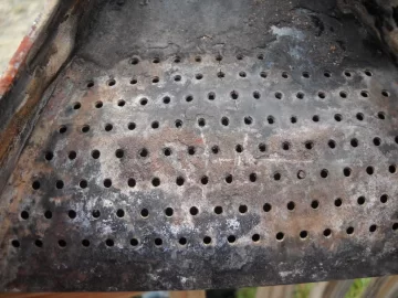

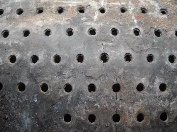

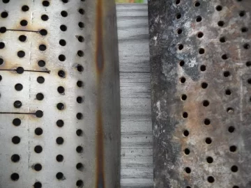

replaced my burn pot today. Old pot had 124 holes...new one has 140+ ...not including the sides. The holes look bigger too [Hearth.com] PB-105 Burnpot Revisited [Hearth.com] PB-105 Burnpot Revisited [Hearth.com] PB-105 Burnpot Revisited [Hearth.com] PB-105 Burnpot Revisited [Hearth.com] PB-105 Burnpot Revisited [Hearth.com] PB-105 Burnpot Revisited [Hearth.com] PB-105 Burnpot Revisited

Picked up a new style burnpot from my dealer today and installed it.
I noticed on the box it said 309 stainless.
Off of AK Steel's website :
"These materials are generally considered heat-resisting alloys. Their destructive scaling temperature
is about 2000 °F (1093 °C). They exhibit good scaling resistance in both continuous and intermittent
service, but the alloys should not be used above 1800 °F (982 °C) for intermittent service."

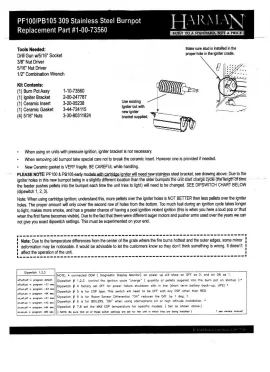

Here is a copy of the service bulletin from Harman that came with the burnpot.
Thanks for the literature! It's nice to see one can still use the new burnpot with cartridge ignitors to avoid the expensive upgrade to the forced air inline heater!

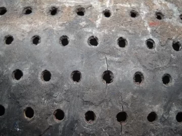

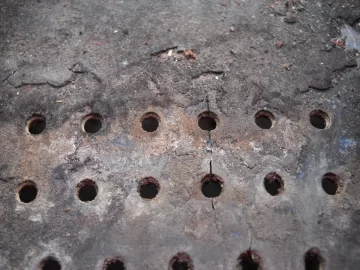

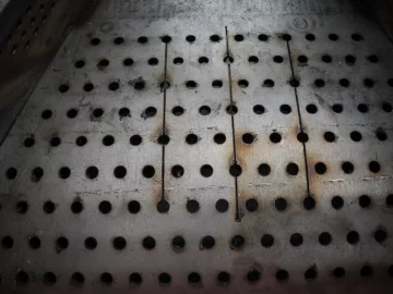

I scrape my burnpot when the hopper gets under 40lbs, every few days. After thirty or so bags on my new burnpot, it is already forming a bubble. I think I will take a copy of the bulletin to the dealer and see what they have to say. This was the burnpot they gave me in September, same look as the old one just has a stainless top I guess.
