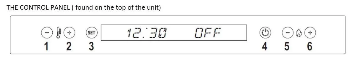

Bought my stove online 1 month ago. Installed myself and stove ran great for 2 weeks burning about 4 bags through it. Went away for a week and since home I get safety smoke warning after 1 minute on phase 1. Flue is not blocked hopper is not open any advice would be greatly appreciated. It is an alf 1 reading by the way. I have no guy in the area that I know of that works on these stoves. Beginning to regret my decision. Did not know you needed to be a computer engineer to run this thing. Help please.

Hi,
there is a cold test of all of the components that you can do first with the F5 code are you aware of this code and how to use it ? see below. Cause if the combustion fan is not working the auger will also not operate and you will get the same message
there is a small coper nut cap just on top of the thermostat probe wire see if it's in place and hand tight properly, it's such a silly cap but believe me if not in place properly that's what you will get as a message too.
*** this message is yes also related to the hopper switch if you start the stove can you ear the auger if not and depending on your ability to do so,,,,
unplug the stove or you will know you havent, remove the front grid to aces to the hopper switch wire and try bypassing them whit a wire or paper clip if it works then you will need the hopper switch to be change

The test is to be carried out when unit is OFF: no flame.
Enter into the MAIN MENU, *** hit 6 for 3sec, 6 until you get to
SETTINGS FACTORY
F5
"cold testing"
Cold testing to verify components. Diagnostic check.
The test is activated with the confirmation of access code F5;
pressing 1 The auger motor activates (as you should hear the motor turning) and the displays shows the letter c .
pressing 2 The igniter turns on ( as you should hear a quick click) and the display shows the letter A .
pressing 5 The room fan turns on ( as you may feel the air editing the unit)and the displays shows the letter V.
pressing 6 The exhaust fan turns on ( as you will hear and feel air being force out the rear flue pipe) and the display will show the letter F.
by pressing 3 ALL ELECTRONICAL COMPONENTS ARE ACTIVED SIMULTANEOUSELY the display shows all the letters A V C F
NOTE: each function may be deactivated by pressing the same button a second time.
It possible at any time to exit from the cold test by pressing button #4.
if still you cant get it to work well give me a buzz some time it's Much easier to go with Facetime or Skype

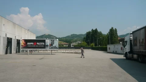

Hey, Hi every one! yep I’m back I see that my friend Chken is always around helping people out this guy must ern a medal. For my part, well fishing and camping all summer plus, I was invited to go to Italy for a week by Piazzetta to get formed as a Piazzetta certified technician all-expense paid. All do I had the pretention of knowing much on these stove, I still learned more specially on how to fine tune the stoves. Soon I’ll post a how to for Piazzetta complete A to Z on what has and what can be change with step by step programme sheet hope it will be suitable for all left aside customers out there believe me Piazzetta are great stove and I will help you discover this. I’m adding you a nice photo from inside the company yard looking to the Rocca di Asolo on the upper left montane. it was a very nice trip I also had the chance to go to Venise and test my Italian language.. it was perfect ! and by the way Lake girl since you are a crew member, If I come up with a complet file like this would it be better to start a new post or do you have any better idea, thanks

È bellisimo! C'est magnifique! (Je parle un peu francais ... very little;lol and most learned in high school from Francophone friends is not fit for polite company;hm;lol) I would start a new thread Pascal. Will check with webfish on whether he would prefer to create a "sticky" like the Harman thread (those ones in yellow at the top of the main page of the pellet forum). A regular thread can be changed to a sticky once it is posted. Merci beaucoup!
