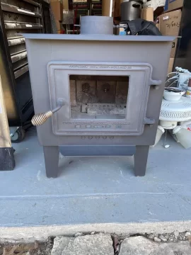

I traded a generator for a small wood stove. Wire brushed it and refinished, still need to pick up the new glass and door seals to install.
It is a Vogelzang Frontiersman Model VG450ELG

Looks great . Pre EPA I take it. Nice simple stove to heat with. Looks like my neighbors who have been using theirs for decades.

They are not pre EPA.

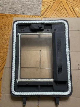

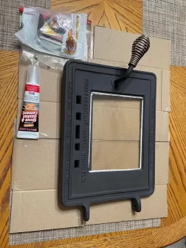

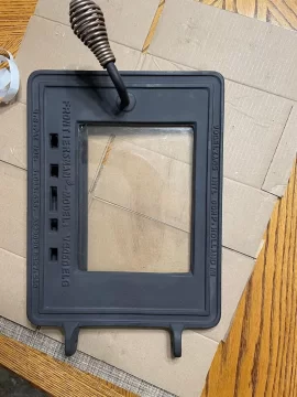

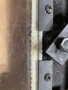

I replaced the door glass seal, first go I really didnt like the gasket being exposed to I redone it today and moved the gasket back about 3/16" to wrap around the edge as it originally did when I removed the old stuff. The old gasket was compressed like paper thin. I noticed on my first try the corners hit the cast iron door but after doing the wrap like the old gasket did the glass has a decent gap between the edges and the door for any expansion. Tight seal all around on the front surface as well as around the edges, I think I am happier with the results. Screws for the glass retainers are snug but not tight as I read to check and resnug after the first fire but not tight as the glass needs to "float" a bit, the glass doesnt expand or contract but the door does ( ceramic glass stays pretty uniform with heat/cool )
View attachment 291661 View attachment 291662 View attachment 291663

If I could, Id have 1/4" ( an 1/8" off each side ) so it fits better without worry of the glass hitting the iron as it apparently has as 3 corners are chipped, but no cracks .
Finally, the door gasket came in, done.

Yes, moved to the main forum. It was a basic, inefficient, 35:1 stove that was sold up to a few years ago IIRC.
