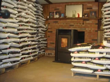

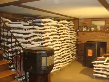

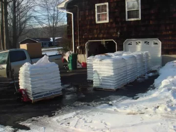

So it is all done!! New stove is in and I have moved in 7 tons of pellets inside. Had already put in 4 tons in Sep 09. Still have to move 1 more ton into the area. then the wife can park inside again. move the pellets inside the garage with a pallet jack. Weather in the New York is not the best so the move inside was to keep then dry. they are all dry inside!! You can see the old Whitfield siting to the side. Time to clean it up and sell it to a good home. I currently have 510 bags left to burn this year :-) New Pellet PIG IN TOWN :coolsmile:

Do you actually burn that stove with 7 tons of fuel right next to it ?
If so you're a lot braver than I am... no way could I burn my stove next to even one sack of fuel. I keep anything that could possibly burn at 5 feet from the stove. And a very big Fire Extinguisher is within 6 foot of my unit.
Nice looking stove though, and you dont have far to go to get a bag of pellets...

You REALLY want to post or find out TODAY if you should store pellets so close to stove.
For safety reasons if something went wrong, ashould have fire extinquisher and carbon monoxide
detector in/near the stove room.
Personally, I would move them to another room. Thought i read somewhere pellets should be no closer than
30ft from stove, I may be wrong, but don't want to find out.

I was thinking the same but wasn't going to say it.
I'm guessing your floor is concrete? I put a ton in my bedroom and the floor started sagging like a banana.

30 feet would preclude you from having a stove in most any reasonable size room, there are things far easier to torch off than pellets in most houses within 30 feet.
I am going to venture a guess, that the pellets are in a basement "family room' or ???
I see what looks like a staircase heading up on the left side of the piccy.

When the Whitfield was in the fireplace it was fine. Yes this is in the basement with a cement floor. We have a raised ranch. The short stack on the right is the one that had me worried so I stopped adding to the stack. It is about 25 inches from the stove. That is why the last ton is still in the garage. I have a smoke detector/CO2 and fire extinguisher right at the bottom of the stairs. Below is from the owner’s manual. It is odd that other combustible materials can be closer then the pellets.
Enviro Maxx OWNER’S MANUAL
Store pellets at least 36†(1 m) away from the pellet stove.
Warning: Never place wood, paper, furniture, drapes or other combustible materials within 80cm (31 1â„2â€) of the front of the unit, 20cm (7 7â„8â€) from each side, and 10cm (4â€) from the back of the unit. Do not let children or pets touch it when it is hot.
I do have a big green chair that I moved to take the Pic. I will be in the chair tonight after I clean up from the snow today. Had 5†before I left for work today.
You all have brought up a good point THANKS! I will move the short stack tonight when I get home to about 48 inches then load the last ton on top. Tonight when I go to bed I will sleep good knowing that I have over 10 tons ready to keep the oil man away from my home OR that I move a ton of pellets today LOL.

Nice looking "beast" you got there. Sure looks toasty! :-) I have a basement install and store my fuel close to the stove. Stick with the manual and you'll be fine. I do try to stay 4 feet plus away just to be safe.

Was pretty sure that you would get bashed for your stacks close to the stove.
Krooser posted a picture some time ago of his stove with a stack of pellets beside it and there was an enormous hue and cry from the pe;llet folks.
Nice stove.
Yep, I see what you mean. manual says 4 ft. I err on the side of caution and store some bags in next room,
about 20ft away. 3 tons stored in garage. Was worried for safety sake.
