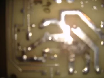

80% FUNCTIONS NOW WORK....BUT HEATS THE LIVING ROOM 100%
I AM GREATFULL TO HAVE IT BACK.
WOULD HAVE TO BUY THE CIRCUIT BOARD, AND NEW 'DIGITAL' CONTROL, TOTAL ABOUT 5-6 HUNDRED BUCKS, BUT FOR 36 DOLLARS, INCLUDING A 15 WATT SOLDER STICK FROM RADIO SHACK...I GOT IT FIXED.

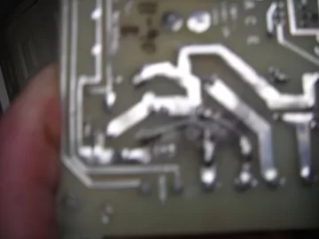

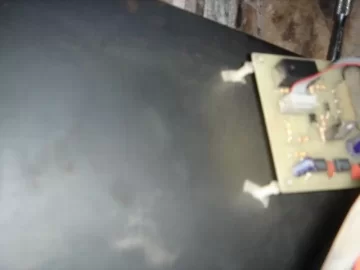

I found a burned solder point on a breckwell p24 circa. 1991 circuit board.
My fault somewhat....loose from plastic pilling holding it on the side panel...touched...now the pellet feed won't work.
My brother said if lucky...solder the burnt bridge...he is 500 miles away, but works and test on big buck communication Sats. Yeh,...said if I am lucky, will let you know if the 'buss' wire solder job works...what have i to loose?
. Ouch....about 280 bucks..
I WILL POST A PIC OF BURNT SOLDER BRIDGE..
