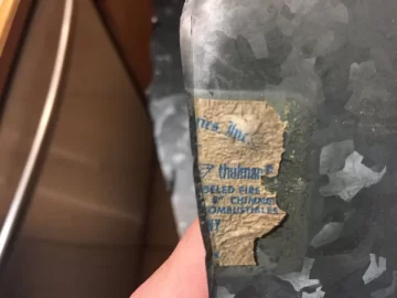

i am stuck, I have a fireplace I need to extend out my roof from the attic. Only need like 6 feet of pipe. It’s a triple wall 6”/8”/11” I think. The fireplace is a majestic thulmar fireplace and chimney from the I’d tag. I found a tag on the pipe but half the tag is gone. Can anyone find out from this tag what it actually is?

Triple wall Air cooled pipe, that brand probably has been discontinued, and is no longer available, unless someone is getting rid of the one they have.
Is there insulation on the outer wall or is that blown-in attic insulation that got in between the jackets? If that is attic insulation it must be 100% removed first, from all lengths.

Do we know what brand the pipe is? Maybe could find on eBay? I will have to look if the attic insulation got in the pipe fully or just some. Your right, don’t want to use if it’s full of it! I got an email out to majestic but not sure if it’s their pipe. Waiting response from them to.
My brother scrapped his a few years ago. Look for someone removing a ZC. There were only a few brands.
