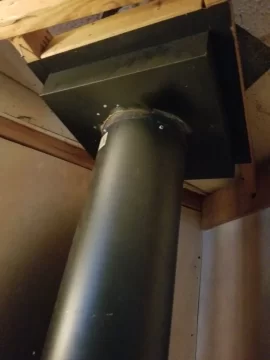

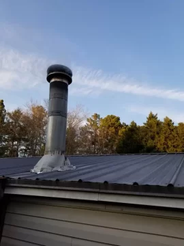

I will try to post some pictures. There is really no "chimney " so to say. This is a mobile home that came with a fireplace. My grandpa had a guy come in and take out the "corner fireplace" and install an through the roof kit for the fisher grandma bear. So inspection should be fairly easy. Other than the part that goes through the roof the rest of it is 100% visible at all times.
Did they replace the old chimney for the prefab at that time or is it still the chimney from the fireplace? I am much more concerned with where it goes through the roof and the inner wall than the exterior.
It was all torn out and replaced. It doesn't go through a wall at all. Just the roof with the square metal boxing
I was talking about the inner wall of the chimney
