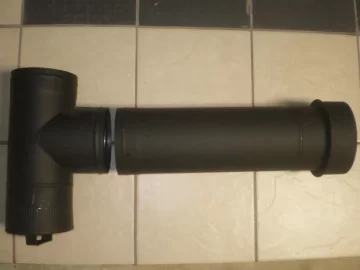

Please reference the picture of my stove pipe coming from my jotul adapter to my "T". The pipe is the same size at the "T" and will not fit. Is there a way that this can be fixed?
Thanks,
Ryan

not familiar with jotul, but you can always crimp an end if it's single wall which it looks like (as long as you're sure you don't have that pipe reversed). Only problem is there's a special tool to do that with, and you probably don't have one. Stop by your plumber or heating guys shop and he can do it.
Then I will get it crimped .
Thanks
