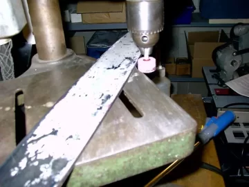

I did my bar on a drill press with a grinding stone ( use a brand new stone). [Hearth.com] Plane Chainsaw Bar
Good Idea thanks WES999!
