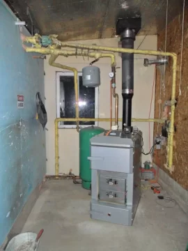

As a previous EKO 40 owner/operator (for 3 years) I can tell you that the effecta lambda 35 I now own/operate (this is my 2nd year of operation) is much easier to start fires in, requires much less attention once the burn is going (due to the Lambda sensor and individual stepper motor control), consumes less wood and produces less emissions in addition to looking very "sexy" (OK, if not sexy I must say it does look very nice).
Effecta has been using the Lambda sensor/stepper motor system for 7 years and thus has a very good history with it. The company has been producing boilers in Sweden for almost 30 years and also produces pellet boilers and solar collector systems along with buffer tanks (this fact should combat any concerns/comments about being a new prodcut to the market). The boiler also is capable of running without the Lambda sensor input if the sensor were to fail (a few simple key strokes on the control panel turns the Lambda sensor ciurcuit off).
Regarding pressurized storage, it is much simplier and in my opinion more efficient since it does not require a heat exchanger. Once the oxygen in the boiler/tank system has been "killed" it's very difficult to have corrosion occuring without oxygen (much like it is impossile to have combustion occur without oxygen). Not to mention, if you have propane tanks availabe locally it is very inexpensive to create.
I would think twice about spending the extra money on a variable speed circ. pump for the boiler portion/circuit which heats up the water batteries (storage tanks) becuase it only runs for 5-6 hours per day when heating up the tanks. At a consumption of 80 watts (with pump on high speed) thats approx. 400-500 watts per 5-6 hour burn cycle. In my area I'm paying about 11-12 cents per 1,000 watts and thus that means it takes little more than a nickle to operate the pump on my laddomat 21-60 loading valve for one complete burn cycle. However, I would seriously consider these pumps for the circuit which takes water from the watter batteries to the house as it will operate much more often.
My system is a very simple system. I pump hot water from the effecta lambda 35 boiler to the top of the storage tanks with one circ pump (laddomat 21-60 loading valve) and then pump water for the top of the same tanks to my residential heating system which consists of a combination of radiant floor heat and baseboard. I use an Azel Technologies switching relay to control the different zones in my house and the system works beautiful!
I hope this helps you in making your final decission as to boiler type/brand and system design/construction.
PS - I have included a photo of my effecta lambda 35 boiler and 2 x 500 stacked propane tanks storage (underneath the blue foam box) for your review (the front cover on the effecta lambda boiler is removed in this photo so that the individual stepper motor draft controls can be seen).
Thanks,
Brian
Thanks,
Brian
