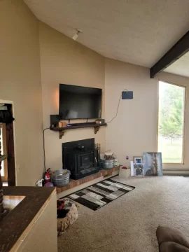

Hey folks, I'm a long time lurker of the forum and hoping the experts on this forum can steer me in the right direction. I'm in the center of Montana and no stranger to harsh winters.
I bought this house a year ago. Specs on it are 2100 sq ft two stories with tall ceilings and some very large drafty windows built in 78 with 2x4 walls. I was going to get the windows replaced this summer until I was quoted $6000 for 4 windows. I did get two doors and a window replaced which should help. It has an old Arrow insert that really goes through some wood. It is absolutely not to code. See pictures... without the fan on I get almost zero heat from it. My concern is for when the power goes out, which it did today for a few hours.

Is the old Arrow inserted into a Zero Clearance fireplace with a metal chimney? And is the goal to remove the ZC and its chimney, then demolish the wall back to the corner behind it?
If so, yes that's possible, and yes, it will be a nice improvement for heat. One caveat with the King is that it uses 8" chimney which will be pricey. 6" chimney is much more common these days.
Awesome. Thanks for the help. Yes that it the ultimate goal. I'd like to take the wall out completely. I have no idea what's behind it, but there is 8 inch chimney pipe coming out the top. My assumption is there was a ZC there before the insert. The hearth itself sticks out 16 inches. The old arrow insert takes up about 12 inches of that. Already burned the carpet a couple times on reloads.
That should work ok. Most likely the old chimney will not work for the new installation. It is probably an air-cooled chimney that is not rated for wood stoves.
