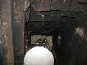

Greetings all - I have read the few comments about the "block" that is shown in most manuals to be installed where the liner enters the flue. I am one of those people - that the installer cut a hole in my boiler plate and refuses to install a block plate that would seal off the house to the very massive space of the old flue. The installer says "I sealed your old flue off when I capped the top of the flue where your new liner (6 inch diameter) terminates - I do not need to install and additional block down lower in the unit." I contacted the manufacturer and they too say this is just a recommendation not a stirct requirement for installation. Well if it is a recommendation - why in the hell does installers not want to do it. I am afraid that the "convection" principals are going to create serious drafts in and around the new liner and cut the performance of my new insert. The home is in an area that gets damn cold - well below zero with lots of snow. I need someone to tell me if this is truly a sticking point - right now the installer refuses to install and I refuse to let it go. I am purchasing an insert because I believe in being energy positive and not having the heat go out the top of my home and getting the biggest bang for my buck. Please be honest to tell me that I am being a typical woman and making more of this than I need to - or is this really IMPORTANT. Important enough that if the installer refuses to look for another installer and deal with the aftermath.... Thanks seaturtle
