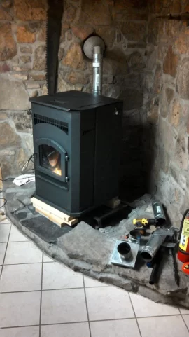

Just bought the 2200 sq ft stove from lowes. It is a really nice stove. I have it in my basement living room which is about 300 sq. ft.. I let the stove run on high all night long. The highest the temp got in the room (opposite side coffee table) was around 67 degrees f. I would think that a 50,000 btu stove would run me out of the room. Fire has a good burn to it so i'm not sure if its the stove itself (using high grade pellets). Stove gets plenty hot but the air temp coming out of the stove feels around 75-80 degrees. I have a 30,000 btu natural gas ventless wall heater that will heat the room no problem. Any thoughts?
Can you describe the exhaust system for the stove? Lengths, elbows, etc, etc. Also, the area is all insulated, I presume?
What brand of pellets are you using?
statesman from southern states brand pellets. the exhaust is the normal 3" line. 90s up out of the stove with a cleanout, about 4 feet than another 90 into an 8" adapter into a chimney. Room was just remodeled. All R5 insulation on block covered with wood tongue and groove and brand new windows.
The chimney has a 8" liner running to the top? The chimney part is new, or existing? If existing, was it completely cleaned before pellet stove install?
And the room insulation I asked about?
Dont mind the base. I took out an old stove. currently building a platform. It was an exiting chimney, it was cleaned this fall and no liner just open

Well, if the stove is running as it designed, even with the rock wall and tile floor, that thing should blast you out of there, IMO.

You have placed your stove on what looks like rock and concrete and that all by itself will remove a lot of the stoves ability to heat the air in the room.
Now about that R5 insulation and specifically what is behind it if you have 6 inch concrete blocks, your total wall R value is less than 11 and I'll give you an additional 1.5 for the sheathing and air films between the layers so call it less than 12.5 which isn't all that great but not anywhere near as bad as a rock or concrete wall or floor is.
Your new toy primarily heats by forced hot air and that requires that the heat exchanger transfers the heat it gets from the hot exhaust gases to the convection air stream, anything that is in contact to that heat exchanger even indirectly without a thermal break will also get heated by conduction and what I'm seeing is a huge heat sink called your hearth and the area behind the stove.

Your heater attached to the wall doesn't have the heat sink (thermal mass) that your pellet stove has to contend with.

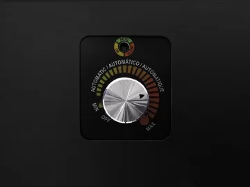

Can we see a pic of the control panel?

this is the only contols

The manual says that extra wire is provided to increase the length of the wire for the ambient temperature probe.
It also says that in order for the stove to enter high fire mode there has to be a difference of 8 degrees between the setting you want it to reach and the current ambient temperature probe reading.
Yep you've got to play with probe placement from appearances.
Is the stove set to Auto or On? If set to auto, maybe just set to On and see if heat output increases.
it has a different control than my PS50. so not sure about the settings there. i seem to remember it has a high and a low and a "dynamic"
the dynamic may be causing it to reduce the feed rate. but i am only guessing as i have never used that control. mine just has low , med and high.

That stove adjusts its burn rate to match the heat loss as measured by that probe. Most stoves exit start up from high burn (this allows them to cycle through their control range and to bring the heat exchanger up to temperature faster). So a change in flame height is to be expected.
Did you do as imacman suggested and take your stove out of auto mode and vary the heat setting manually?
