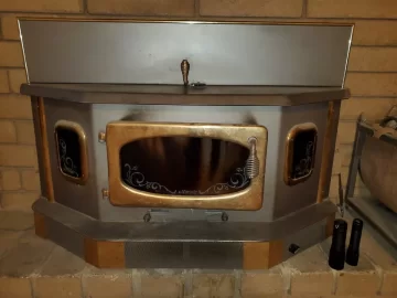

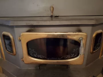

Hello,

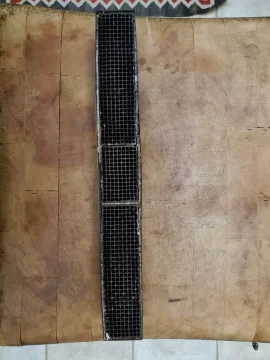

We bought our house and I need help identifying this wood stove insert. It looks like a country flame or Lopi but I can't find the exact model. There is etching on the glass (scroll work) with the word ultimate on the front glass door. The bypass is located above the temp gauge and the top of the stove. (I've included a picture of the stove and the catalyst for easier identification). The problem I'm having is smoke buildup and drafting problems. I'm thinking that the catalyst might be the problem due to age and wear. I would like to replace the catalyst to see if it improves the performance of this stove but I don't know where to start without the Make and Model of stove. I really appreciate any help or info that anyone can provide!!

It resembles an early Country Flame, but key details are wrong. Notably, the short porthole side windows and the door is hinged on the wrong side. I was thinking this looks a bit like an early High Valley, but unsure. You might be able to take the exact dimensions of the cat to a site like Midwest Hearth or Condar.

I have never seen one, but Heatilator had a very early catalytic insert the Arrow 25 or 2500. It had a 3 part catalyst like this in a screened metal box. I stumbled on this looking for info on this early insert. You could contact Woodmans to see if they recognize it. If so, let us know.
You may be able to ID the insert by pulling it out and checking the cabinet for a UL tag on the sides or back.

Is the Cat plugged when holding it to a light and looking through it? If it is nice and open your smoldering and draft trouble are caused by something else. If it's plugged you could try gently blowing it out with compressed air. Even if the cat is not lighting up it should not impede smoke passage or alter your draft. Is there a plugged screen on your chimney cap by chance? Gotta ask.... Have you confirmed that you wood is dry enough to not smolder and smoke excessively? These are a few things to confirm.

The Cat is NOT plugged but there was a lot of fly ash packed around the Cat when we pulled it out. We vacuumed and cleaned the area so that there is no more loose ash. The Cat is black, has minor flecks missing. When I've burned I've never noticed it red and it is right in the front of the stove when you open it up so I think it would have caught my eye. I've had a hard time keeping the stove above 700 so I'm thinking a new Cat will at least hopefully solve the heat issue and fingers crossed our draft issue. The chimney cap is clean and the lining have been professionally cleaned and still smoking/backdraft. The wood is seasoned and very dry. Thank you for your thoughts I appreciate it because I really want to use our fireplace this year!!
