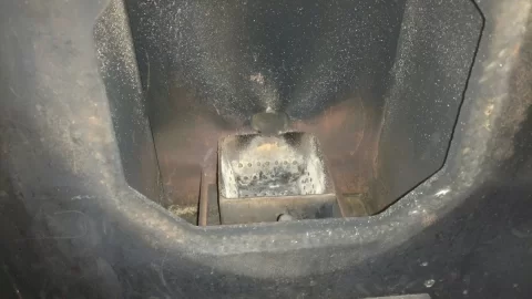

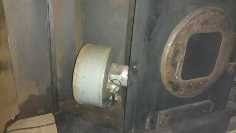

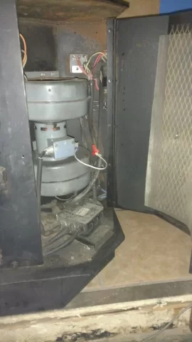

I am glad to have come upon such an awesome forum. I am new to pellet stoves, here is my story.
I won a pellet stove at an auction, nothing was known about it. It is huge I'm assuming between 2 and 400 lbs. I have new pellets and have thoroughly cleaned this thing by way of removing everything.
Following YouTube videos meticulously.
I can't burn without the hopper chute going up in smoke. 2 questions,
1, I have searched high and low and there are no metal stampings anywhere on the unit. Does anyone recognize this model?
There was zero information on the auction so no manual or anything. I have no idea the make model or manufacturer.
2, the pellets are getting stuck near the exit of the chute. Then the fire lights em inside and next thing you know hoppers smoking bad and the pellets are stuck.
I have no manual or diagram of how to even use this stove. I can't figure out why the pellets are stickin. There is a bit of a ridge before exit that feels like a weld bead. Should I grind that down?
Any and all help is appreciated. With that said I just moved to an old Uninsulated farm house and I need the efficiency of this stove. The hour I got it to run great was amazing. 35 degrees tonight and I am tired of spending $7.50 a day on kerosene.
I love this stove and I have done so much to it I will do whatever it takes to make it run efficiecient.
Here are some pics.

Hi and welcome! I have seen a stove like that on the local Craigslist. It was listed as a Dove-tek. Maybe that info will help.
Reactions: FirepotPete
I hate to say it, but cut your loses and start looking for a newer pellet stove. You are going to have trouble finding parts and support for it. Additionally, does it have the safety sensors that most modern stoves have now? How safe is it?
Jonkman I wish I could buy you a beer my friend. thank you so much for giving me the answers I need. I went to the grain elevator this morning and I am burning corn atm. in frickin believable. I am burning corn lol. I love it.
Vinny it has been operating now for about 2 hours. seems to be operating smoothly even though it is a little loud. I'm just happy to have heat. I probably will only run it during day until I get detectors and stuff for safety. the fans are dayton and should be easy to find aftermarket replacements I'd think. I follow what you are saying though. I am new to this so if this winter goes good I'll go ALL in next year. you guys are amazing thank you so much for the info.
