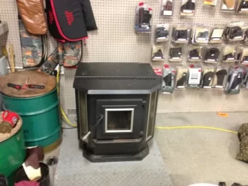

Can someone please tell me the model of this and the center of the exhaust height?
Please and thank you

I don't have one but looks like a 25-PDV. Specs
Heating Area 2200 sq.ft.
Max. Heat Output 42,000 Btu.
Automatic Ignition Yes
Manual Ignition If needed
Hopper Capacity 60 lbs.
Fuel Type Wood pellets
Glass Air Wash Yes
Built in Blower Yes
Convection Blower Capacity 250 cfm.
Thermostat Compatible Yes
E.P.A. Approved Yes
Efficiency 78%
Emissions 2.6 gr/hr
Dimensions
Height 30 in.
Width 28.5 in.
Depth 28.5 in.
Weight 375 lbs.
Window Size 8.5" by 8.5"
Flue Vent Size 3"
Top Vent No
Rear Vent Yes
Rear Vent Height 15.9"
Battery Backup No

I am pretty sure it's 16" center (15.9") that goes for almost ALL Englanders.
Thanks. I am replacing it today and has a block wall. SDS on standby.
Correct...ALMOST all. 10-cpm is a hair over 17" to centerline.
The CPM mounted right up to where the PDVP used to be? They had the same Center?
Pretty sure it was 16"? My old 1996 25-PDVP and my Dads 2001 PDV had the same Center. The CPM was where the old PDVP was in my shop, and it plugged right up to where Dads 25-PDV was (CPM is now my Father's/ He loves it)
Maybe it is 17"? I gotta check now :)
