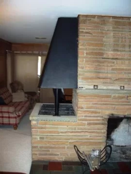

The only problem is that the downstairs fireplace shares the chimney with a second story indoor grill!
  • [Hearth.com] Plugging a chimney!!!
Wha!!!
I hope you have LOTS of carbon monoxide detectors.
You never answered me if it was a gas log set or what? I will assume it is just a gas log.
Ok... first of all, I don't even know what or how many codes that violates but I'm sure there is more than one. Secondly, totally blocking off a flue with gas logs in it is illegal if you have a pilot kit on it. Is it a match light log or a pilot kit log set?
When the gas log is running if you had a pressure issue in the house or a down draft the axhaust could be spewing out of the opening for the grill.
I just don't even know what else to say... and I have to make dinner.

I still don't see what the issue is with making a 30" x 27" plug (or door) to fit in the fireplace opening, not in the throat of the chimney, but right at the fireplace itself.
No problem, but it will not solve the problem 100%
