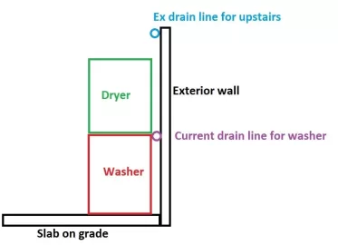

1. is my diagram, below, a proper wet vent? is there any additional p-trap required? at this point in time, i'm not totally sure about where the vent to the roof occurs. i know there's not one by the kitchen sink, and i can't picture one anywhere else along that exterior wall. guess i will find out when i tear off some drywall.
2. i could see elevating the W/D 2-3 feet off the floor and use a cabinet with sliding drawers underneath. would need to consider this. otherwise, it seems the effluent pump seems like one more hassle. seems to be about $200 + incidentals. obviously, would need to do some research since plumbing is not a strength of mine.
the existing plumbing i could tie into is about 7' off the basement floor in a chase for a lot of the service for the kitchen (water lines, electrical, etc). hence, there'd be a 7' height difference between new washer and tying into existing kitchen plumbing. does that make sense?

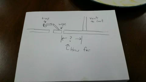

anyway, is the wet vent sketch i drew more or less correct?
I think you need a P trap. Without it, sewer gasses will leak out. Every laundry drain I've seen in the walls is equipped with a trap.
x2 on needing a trap. Check my sketch. How far is it to the vent?[Hearth.com] plumbing for washing machine

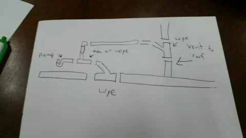

If it's a long distance do it like example #2

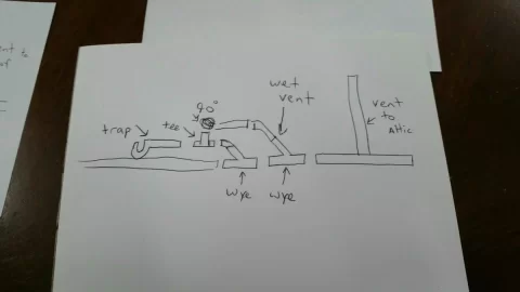

Another way to do it.[Hearth.com] plumbing for washing machine
This is a true "wet vent" The trap is being vented by a pipe that has water that flows down it, thusly it's wet.

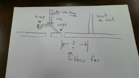

Another way to do it would be substitute all the vent work and put in an air admittance valve. This method is sometimes the easiest but least desirable because the AAV can fail over time as a pipe will not fail.
Sent from my SM-G900V using Tapatalk
Just FYI air admittance valves are not accepted by some local codes.
Also, if you do use one it has to be accessible for checking and service.
Yet, it may be your best option give that your horizontal distance to a vent is 10 ft. That seems to be pushing it.
