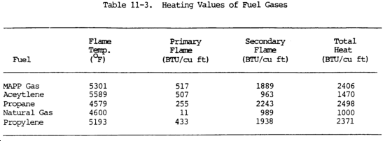

For a valve, with more mass than pipe, consider buying a tank of MAPP (methylacetylene-propylene-propadiene) gas, rather than just propane. Each of those three compounds is a C3 chain, like propane, but with double and triple bonds between carbon atoms. The energy release on oxidation is much greater, giving a higher flame temperature. This lets you get the soldered area up to temperature faster, with less heatup of parts more removed from there. You can always wrap a wet rag around the valve body away from the heated area to absorb some of the heat, too. But valves with sweat fittings are regularly connected without disassembly.

Good point. Can't believe there's anyone out there still trying to use propane for sweating pipe, but I guess it's worth saying. I use MAPP handheld for small jobs, a large acetylene tank with hose for the larger jobs.

Acetylene is nice. Hottest flame, lowest radiated heat. MAPP is nice for amateurs, since you can be sloppy with your flame distance (hotter secondary flame), but you can't easily work as close to combustibles with it.
