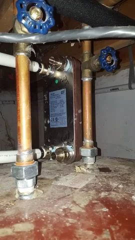

Got everything all setup, looking for tips on plumbing cold water side of heat exchanger. I was thinking 3/4" sharkbite fitting to pex. Thoughts? Is there a flexible pipe that will work? Basically just need to cut the cold pipe and put fittings running to heat exchanger.

Why not just copy the other side connection process...just sweat fitting for copper to pex...
