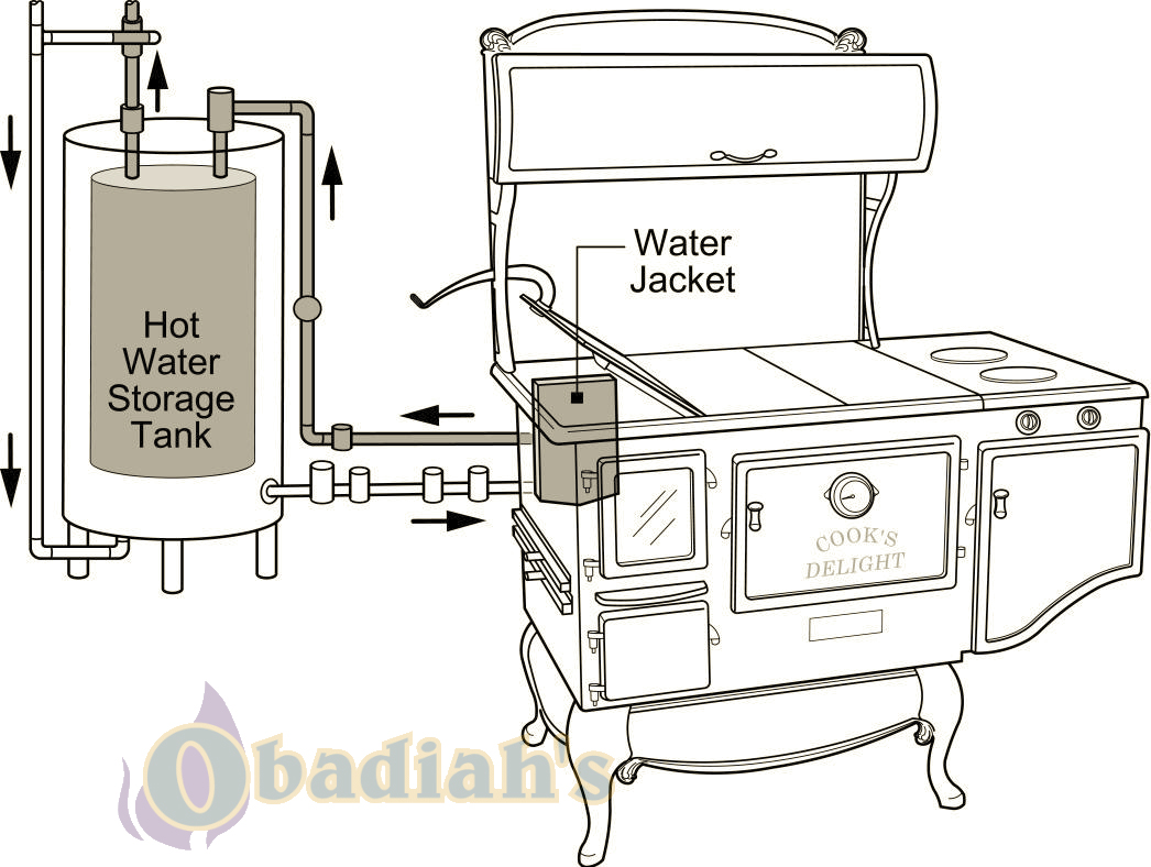

Indeed. This isn't a full blown boiler, but a domestic hot water system powered mostly by hot water loop in the cook stove.
My goal is to create a thermosiphon like at the above link under the "passive" system diagram. My range boiler is on the floor above where the cook stove will be. The actual tank will sit above and a few feet to the left of the cook stove/hot water coil. I think the hard part will be integrating the solar water heater into the system.
I attached a similar setup.

Indeed, it should NOT be a boiler! According to my research as long as I have one foot of rise for every two feet of run I should be able to thermosiphon. The trick is going to be making this all aesthetically pleasing...
Edit: I'm also going to use 1" pipe from the range boiler to the DHW Coil.
