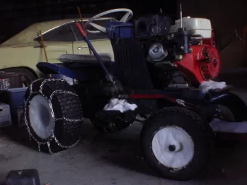

Here's a project I just finished. I can't get to the woods anymore on foot and lots of times it's too wet for my big old tractor. I been wantin' something to get me out there and back and this is what I came up with.
I paid $150 for two old bolens garden tractors and the pick-up truck pulling tires. I paid another $100 for the old B&S;single lung 16hp motor. Add new points, condensor and four longer belts, I have about $350 into it.
These old engines start easy when they're right. The carb was a little too much work but you'll notice there's no battery or charging system. Wrap the rope around the front pulley, give it half a hearty tug, and she's a chuggin'.
It is double belt drive to the driveshaft and double belt drive for the pto (front & rear).
It's got a high and low gear, six forward, two reverse and a locking differential. That all equates to some serious pulling power for such a small, cheap, system.
I like it a lot and wanted to share the idea with others.
Ken

That thing is pretty cool! I bet you had a blast building it and alot of satisfaction using it for the first time. Pat yourself on the back, good job!!!
Whaddya gonna call it? Rick
Thanks for the kind words. It really isn't much fun in the shop this time of year, no heat. I'd rather be stirring up trouble on the computer. :coolsmile:
It is fun to drive and it'll do more than I'll ever need it to.
Thanks again-
Ken

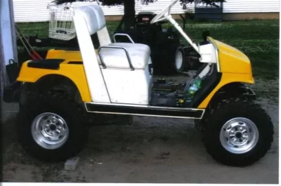

now i am into the golf carts thing,putting a snoplw on it and saving for a 18 hp b&s;. i did the lift myself and the rims and tires are off a polaris 4 wheeler.
folks around town laugh like heck when i ride her to the store 1/2 mile up the road. with the big tires i get about 20 mph.
mike

Here's a pic of my cart. It's a workhorse. It's surprising what they can do. I use it to tow my splitter and haul all of my wood to stack.

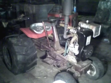

I have 2 that I inherited from my Dad. Here is one of them, it has a cheap Chinese built Honda ripoff 13 horse that is a real stump puller. Probably not in the same league as that long strokin' Briggs though. I put a varible pulley on it for snow plowing duties, it's about 7.5" diameter on full squeeze. It will run about 17 mph with that big sheeve. Thats fast enough to roll the snow off the blade! I also use it for tilling and wood haulin' duties, even bush hog with it a couple times a year around the woods. I love them old bolens, I think the old man gets a kick looking down from heaven seeing me still beating the crap out of it. I don't think they make a tougher little tractor, it has withstood my abuse on and off for over 40 years!
  • [Hearth.com] Po boy's 4-wheeler
