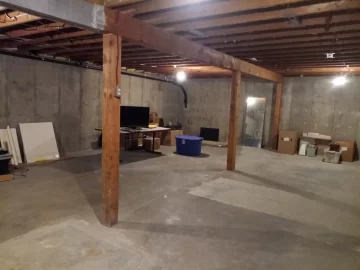

I'm starting my own basement reno next year, blank slate on the inside right now.

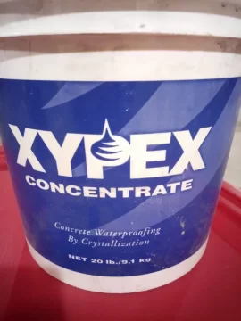

This stuff is your friend, I'll be "painting" all the concrete with Xypex.
