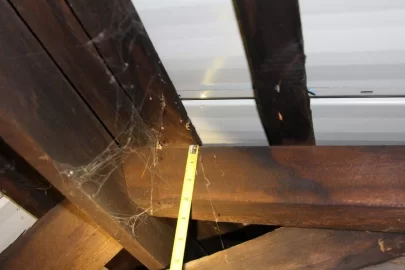

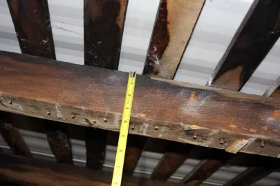

Right above that doorway at the one gable end take a look at this. A tad bit of fire damage. The ridge beam (is that the proper term?) is severed 2 foot from the end, as well as several purlins (though the purlins look cut, like maybe there was a chimney up through this end?
[Hearth.com] my insulation project, not exactly as planned
The metal roof was new in '07, a year before I moved in. So they obviously knew of it and just slapped a new roof on over top. I'm not sure if this is something critical, I didn't really want to get into a massive repair, I allocated about $2k for insulation and refinishing these rooms, doing all the work myself. Maybe I can just clean it up a bit and insulate it and continue on.
Funny thing though, before I had actually got to that point and just started the demolition and the neighbor (previous owner) came over to see what I was up to. They said they had 2 or 3 chimney fires years ago, though she mentioned it was from the other chimney which is in the next room over.
Now that I have most of the demo and clean up done and I'm really studying the structure, I see some other potential issues. For one, the roof trusses are not all equidistant. I mean I bought several rolls of 24" wide R-13 batts. I measured a couple before I bought, but now they are all exposed and I measured them all. The distance between the roof rafters are: 19.5", 20.5", 21", 20", 24", 20", 18.5" and 22.75", on the currently exposed ones. And they aren’t straight, measuring 1-2" different in width from the top to the bottom. Also the size of the rafters seem to taper, most at the bottom are around 3.5" tall while at the top 2.75". I've never put down insulation before is this a big deal can I stuff R13 in there still? My other thought was since I was going to put down a very thin foil faced EPS sheet first, and a thick layer of EPS on top of everything (right under drywall) when its done, maybe I should just use EPS all the way through. Will be a lot of cutting to shape though. But I plan on spay foam sealing all the edges (between foam board and trusses), so it doesn't have to be an exact fit. problem I see with all rigid foam board is the tapering of the rafters, 3.5" thick of EPS will be flush at near the sides of the roof but at the peak the EPS will protrude 3/4" from the rafter. I suppose that would still be ok though?
But now I'm wondering if I should be ripping all the roof off and putting up new 2x6's and sheathing or something like that. :confused: Which would be beyond my ability and more than I was going to spend for sure! Unless maybe I can put up some new boards from underneath without taking the whole roof off or something like that.
At least its a good time of year to have half the house torn up and air leaking right in. I am somewhat flexible on time, I can live without 2 bedrooms and already moved my son to a downstairs room, but the laundry room will be missed. Can always run a garden hose and extension cord to the washmachine outside lol.
If anyone has any advice I'm all ears.

Hard to tell how bad the fire damage is from the pictures. It looks bad but you only take pictures of the bad spots. I would consider shoring up the the burned up areas. I would suggest using 2 inch XPS sealed along the edges for the insulation. Its only R-10 but sealed and installed properly it may be better then what is in the rest of your house. Dont use bats they will work very poorly on the slopes if at all.
What contractor is willing to put up a roof on top of that!!!
Long shot but it looks like there may have been a chimney there, where the new doorway currently is. Was this a bad chimney fire possibly. Show the previous owners the pics. See their reaction.
Reactions: Ashful
Yeah its only that one spot really, effecting the last two trusses just the area in a couple foot diameter. There is some black marks here and there throughout the roof but nothing bad. Yeah I am realizing the batts just aren't going to work well. Unfortunately already bought them, but I assume they are returnable. Going to be a lot of measuring and cutting with foam board isulation since all the rafter bays are different, but I assume I can cut them undersize a bit and just seal up the ends with spray can foam.
That's what I'm wondering. Since there is no sheathing its impossible they were not aware of the damage.
That is what I was thinking. Looks like a cut out for a chimney, and all the charring is worse right at that end. No way I don't believe a chimney fire from the current chimney 15+ feet away could cause so much more damage there without hardly a trace in between.
No real contractor would put a metal roof on such a structure. Had to be the homeowner or one of their good friends to do such awful work. Unless maybe they paid a lot of cash and no receipt! Guess there's all kinds.
