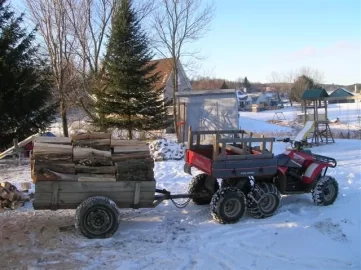

This is my wood hauler. I'm using it on my friends 150 mountain side acres. Of course it broke right in the middle of the project. He is letting me use his atv, but there is nothing like hauling with a 6X6.

Right on about the 6-by and its use as a wood hauler. I bought mine exclusively for this chore. I have 4 other atvs for what they do, none of which excel at wood hauling as the Polaris does.
